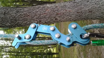

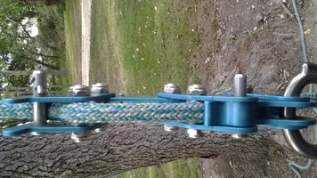

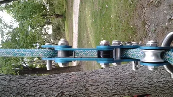

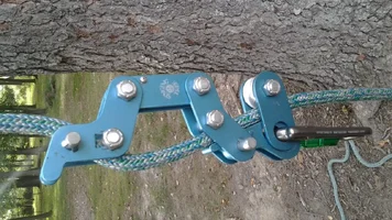

20140903_164938.webp 20140903_165035.webp 20140903_165148.webp 20140903_165059.webp Adjusted the bollard and was flying for 3 hours today. Opened the bollard all the way and it was perfect for me on both my Vortex and my 12mm Donaghys NRG. Teathers well although I have some bridge length adjustments I need to make. Might try Yoyo's idea, I need it tighter than will fit over my hips and who wants to retie it every day. I included some pics of my Vortex/RR combo. I am hooked, it worked as well as has been described in here, a real pleasure to run. Nice job again Kevin.
