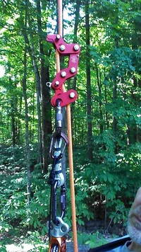

OK....I could not wait to heal before trying out the RR. I set it up with a short sling to the bridge to place it high enough that I could use a chest roller under it, allowing me to climb one armed.
Up 15', stop for photos and on up to ~40' where I could stand on a limb and tie off to remove the sling and extra biner to get the RR in a normal position to descend.

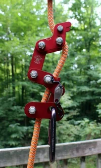

My first impression is that the RR just became my go to ascend/descend tool. I also like that the bird does not place as sharp of a bend radius on the rope as the Rope Wrench does.
I had almost forgotten how nice it is to climb with a chest roller and it tends the RR very nicely.

The sling was used to place the RR above the chest roller for climbing. If the chest roller is placed above the RR or hitch hiker, etc., you can't sit in the saddle without the chest roller preventing the RR from grabbing. With the chest roller below the RR, it tends the RR up as you climb and does not interfere with the RR's operation when you need it to grab.
To me, this setup is less than ideal, but it is the only way I've found to use the chest roller with these type off devices.

I did a few large white pine removals a few weeks ago using the runner. By the end of the day my rope was really gummed up in a few places. I don't honestly think I would have been able to pass a hitch over it. The runner barely noticed. It just got a bit jerky on the really sticky parts. My gear got so covered in pitch I had to take every biner and bit of rope home over night and wash it. The only pitch that stuck to the runner was where my nasty ass hands had been groping the bird all day. Cleaned that off and the next day it was good to go. This thing is really a great tool. It has taken me a while to really get the feel for descent. But now i am a true convert. Since I got the runner I have not used a hitch. I have been using the bulldog bone as well, but still... No hitches.
