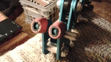

We're thinking in the same direction. I dipped mine in Plasti Dip. It has three coats in this photo and I just dipped it a fourth time.
I suspect it will not be durable enough and may peal off. If that happens, I'll try your hose fix. Thanks. If you cut the back edge on an angle it would give a little more coverage.

I thought about Plasti Dip but had the same fear. I've been machining some one off custom parts and sharing those concepts with Kevin, but I am trying to keep my mods on here to stuff that is simple, cheap, and can be done without an entire machine shop, lol.

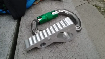

Add the "hump" and the bird is so smooth and easy to operate you will not need a cushion on the wings.
I have a milling machine and will get bored this winter. Anyone see a problem using the 6065 T6511 aluminum I have on hand in this application?
Of course, if Kevin made a modified part with the hump, I could buy one.;)

gmcttr, I have been using 6061 that I have laying around, as long as you stay low and slow you will be fine. I also have been slowly leaving more metal. More is not needed, but less machining is just quicker. Think Triangle and I leave the biner area solid. The original has a lot of weight reduction and cool factors but for tweeking at the moment I am just simplifying.
