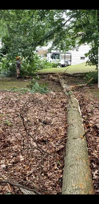

back to this pic Rico.. you called it "fucked up"...
I would like to have an intelligent conversation about it.. maybe someone out there could learn something that will end up saving his life or some property damage.. so beyond all the posturing and ego, can you offer some constructive criticism, instead of just throwing mud?

What I am saying is that the small undercut you are making is unnecessary, and actually counter productive. It is creating space that will allow forward movement, which we don’t want in a slice cut. If you are doing that on something large or with a lot of weight above your cut, you could be staring at a barberchair in the blink of an eye. No Beuno!

First tree I did this on was a dead maple with a nice full canopy... there is a small hole that the entire top will fit in if I can get it there.... If I try laying out the entire top with a standard notch, it will either lay up into the surrounding trees or damage something on the ground. The hole is right near the tree. So I need to move the top towards that direction about 15-20 feet and then have it drop like a stone. If it lays out completely damage will be done. BUT if it doesn't lay out far enough it drops, the limbs on the back side of the tree will come down on me, which could easily kill me... The tree either has slight front lean to the hole or we put a pull line in it to make sure the tree will go our way. That's what this cut is used for... When you want the top to move before it drops, which of course could never be the case with a hung tree... top isn't going anywhere but straight down!
0% chance of BBC due to species and not enough front lean to split the trunk, and the strength of wood grain due to branch unions and the fact that by the time the tree moves there will be only the tiniest amount of hinge wood holding the top and bottom together. The width of the hinge is adjusted according to how far you want the tree to move before it drops. You need to account for some stretch in the hinge fibers which could be 10 degrees or more additionally after the face closes depending on species, thickness, live vs. dead etc...
I understood your concept and explanation of this double slice cut. I could not, and would not get away with making a cut like that with the trees I deal with. It would bite me in the ass hard.Stay with me here...
