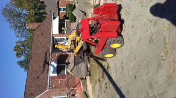

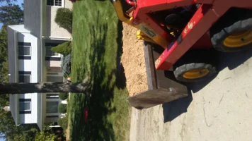

I was always Curious how the tracks did on those... Ive had real good luck with my kanga. Very rarely do we bring the new holland ls180 out. It tears up the lawn. I think as was said earlier if you can have both that would solve all your needs! Id like to get rid of the new Holland and replace with a 6? Series avant.. By the way my kanga has an edge on all the ramrods, dingos, bobcats and vermeers in my area. These are all older series machines like mine, i haven't had a tx1000 series to demo yet.. I really would like to go to a track style machine. I cheated by modifying it a bit with a weight kit and larger bucket.
