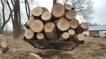

Nice job on the Bucket - I am going to start making a good sized mulch bucket like that.
Avant has the best selection of high capacity buckets on the market right now. butt no universal hitchs
american after market buckets are generally to small for our work, and all these minis can handle
larger capacities. ADVICE if you are buying a machine and a bucket, compare cubic feet.
most the mini mfg dealers will sell you a 4~5 cubic foot capacity when you really should and most likely your/most machines could handle ~15 cubes easy,
picture is a 10 cube mulch bucket (spendy $740 list)

My apologies did not mean to derail this again for pure economic gain. The ever so small connection to the toro 1000 is : experience over the years is guys have dealers throw a bucket in when buying their loader for say 5~600 bucks. (everybody needs a bucket now and then Right?) Trouble is many guys did not put a lot of thought into the bucket the dealer was selling them. So they wound up with a little dirt bucket maybe 5~6 cubic yards - pretty worthless for mulch - firewood snow etc. Have heard the story from muchos tree guys. Now with these more powerful minis toro 1000, vermeer 1000, boxer 950, DW 1530, even the mulch buckets on the market for these minis are pretty wimpy @ + - 10 cubic feet (Arrow $740) all the machines mentioned above can easily handle twice that in mulch, firewood and rakings.
As I may have mentioned before Avant has the best selection in bucket sizes - but look around on the net for a sweet large debris bucket that fits a T1000 - and there just aint anything.
Helped a lot of guys steer clear of the Dealer stock buckets recommending they request high capacity buckets, Just trying to pass on what I thought useful info on Buckets - not bold enough enough to start a whole new "mulch Bucket thread". I decided to make something different and better a better value for all tree guys.
