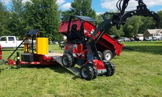

Or, if you're up for spending the extra $$ you can have a low platform trailer built with side doors in front to load a Giant sideways. I should have pictures of my Avant loaded sideways in a 14 foot dump trailer in the next weeks.
Let me know where you had the trailer built and how $$?

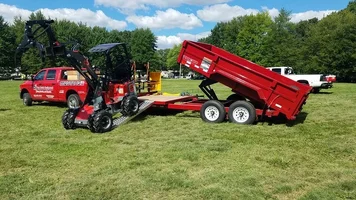

Yes, I think this pictured layout with platform in front of dump bed is cheaper.
I do a lot of pruning work, some removals and a smaller number of removals with lots of big wood. I wanted to be set up to, at times, haul back from a job with the loader up front and up to 9 foot logs in the back. At other times I will leave the loader on site while I go and dump a full 14 foot of logs and wood.
Carl was good enough to go through all the headaches of back and forth endless emails etc to get it just the way I wanted. Midsota is the trailer company that is building it.

My problem with a platform dump is you never can haul/dump material on the platform. With Merle'a trailer you can take the front section of the walls out and use them as headboards in the bed. That leaves room for the machine and the debris in one trip. The downside is you may want to remove the machine before dumping.

As you can see, I'll have 4' 6" wide for my platform in the clear.
Exactly 8' across.
What is the distance from the front edge of the coupler to the most rear of the machine?
Is that what the 88" "length without bucket" dimension is?
Heck, I may be able to haul it with the BMG attached...
I think it will just fit.

That's the 88" number. It's 102-103" with the BMG on the machine.
For the work I do, the 254T beats any mini I've been around.
Unfortunately for BME 254T, with the BMgrapple it is 103" long. So for now you have to take the grapple off to travel sideways down the highway. PIA, as far as I am concerned. Looking into modifying the BMG hanger to get under the 102 requirement

Trailer looks great what about tongue wait any issues when trailers fully loaded and with machine on it
3/4 ton with a base 420 is cool,
the BME 254T or a 528 is right on the edge of safe with an empty box. common sense loading and balancing the dump load actually makes the trailer more stable.
Start counter weighting the machine - foam fill the tires, Custom BM tool rack and you are going to need a 1 ton minimum, or you are going to have to put the machine in the rear when the box is empty
