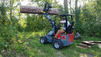

Thought I would add some more pictures of this little beauty
9_21_16phone 318.webp The dual's - under 36" option
BME 254T next to Avant 528
Right after I snapped this picture Carl dropped this log, :reloco: Scared the crap out of both of us.
No damage, no Injury, thank the good lord

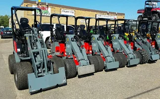

Branch Manager Machines are in stock (y)
