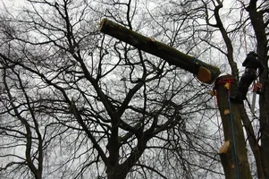

Attached, a way better pic than yours David.
