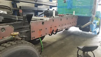

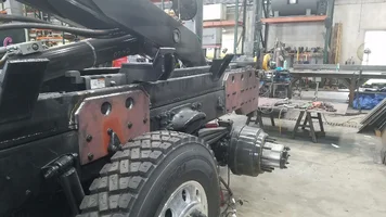

My knuckleboom hooklift mecanil sg160 build
On your footprint truck diagram (on your website) it says your Gvwr is 50,990. That is why I was confused, cause if you are 20/46 wouldn't your. Gvwr be 66,000?
Yes but I put what palfingers drawings said for the truck. They gave me a curb weight and a max weight. It doesn't add up to the springs though. My curb weight is 54k and my max is about 59k. The web site was done before I actually put the truck on the scales.
Also, he needed the weight of the hoist anyways.
My rear mount truck has ~4400lb of weight added between the front headboard and front bumper.
So the added weight is ballast when the wheels are off the ground... do they ever add weight to truck mounted stick booms?
Knucklebooms you never want the tires off the ground, it is part of the stability. You just lower your outriggers to just slightly extend your suspension.
I'd assume so, yes (add weight to stick boom trucks). You need counter weight to lift weight.
