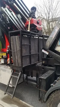

Lower mat rack, with grapple saw mount. Holds 16 3x8 mats.20190318_074100.webp

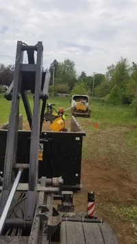

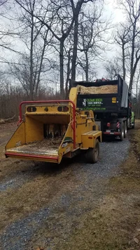

Pictures of the truck being used, crane and hooklift
20190517_132126.webp20190506_164354.webp20190502_142123.webp20190502_143648.webp20190315_111431.webp
Many more on Facebook and Instagram

How practical is it unloading your own mats? I’m assuming that whole cage unloads? I was going to make something similar but Was reminded I would have to set up twice to do that so I store my mats on other trucks.

Mat rack is bolted to the frame...so is removable but not really lol. 3x8 mats are not too hard to move with one person.
