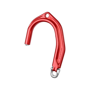

Ha! As I say to climbers, don’t throw it where you don’t want to go. I have no idea why but it doesn’t get stuck unless I intend it to. Maybe because I learned how to fish in swampy woods brooks when I was a kid ;-)
I’m working on a bunch of dead vertical poles this week, dead or mostly dead red pine. Established a high tie-in on the one good one, the Captain Hook makes life better going from one to the other. I love to climb too ;-)
The thing about the Captain Hook is that the design causes the hook to aim up when you pull it back quick and down when you pull slow to hook the branch, wicked kewl design.

Now that surprises me. Of all the times I have used it, it has always worked and has never been stuck. Guess I've just been lucky.
I once got it stuck on a limb that was a fraction of an inch too large. I could get it to pivot and rotate but it just wouldn't come loose enough to get it off. Came back the next day to retrieve it.
Another time, it caught two springy limbs that exerted enough spring to keep it from coming loose.
I think I've put in an hour of effort for every 10 minutes of use I've gotten from it.
Haha, so far in two days on this multiple dead red pine job only used the hook once ;-) What really counts when you need to go places horizontally is taking the time to establish an excellent high anchor point to work from.
