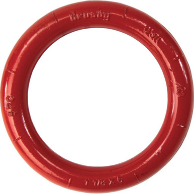

I glad you said that, I was thinking about a shackle, I don’t see any reason it wouldn’t work but wasn’t sure if that was kosher. Wouldn’t want the other arborists laughing at me later, ha.Haven’t read all the comments yet. Crosby makes a couple of different sizes of very beefy rings. I’d avoid using rigguy or the other type in a configuration like this unless you do the box x version for a three part system.
The logic is a hub and spoke still allows a lot of movement with restriction only outward. This is likely to wallow out the holes unless fixed hardware is used.
I think I bought the last of them from the clearance section, the link is the bigger ones.![]()
Crosby Rigging Ring - 1 1/8" x 6"
Crosby rigging ring for rigging applications and crane work. Made in the USA.www.wesspur.com
A moused shackle would also work but I’d have the two legs fairly long to avoid a wider angle. Probably 60 degrees?
Could also do a hybrid, dynamic triangle with a steel Y the dynamic can be slightly slack and higher than the steel
With those angles, I think a beefy shackle could be pretty legit. Maybe a little welding to lock it shutI glad you said that, I was thinking about a shackle, I don’t see any reason it wouldn’t work but wasn’t sure if that was kosher. Wouldn’t want the other arborists laughing at me later, ha.

Technically I don’t think you should have opposing loads on the bow of a shackle. Yet we probably all have done it and as long as the angle is kept in check should be fine. I’d make damn sure couldn’t spin, wiring the single leg in place to the pin if the thimble can pass the shoulder.I glad you said that, I was thinking about a shackle, I don’t see any reason it wouldn’t work but wasn’t sure if that was kosher. Wouldn’t want the other arborists laughing at me later, ha.
There’s not much spread between cables, maybe 10*-15* and not much weight involved either. Biggest stem is probably no more than 5 hundred pounds in full leaf. Others are significantly smaller.
Biggest might even be less than that, I need to go back and look.
45 would even be alright>15⁰ isn't asking toooooo much of it I think.
