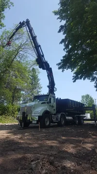

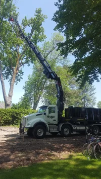

Here is a package that was recently delivered here in Ontario.
HIAB X-HiPro 638 E-6 with Jib 150X-6 - Mecanil SG220RC and Multilift XR16 hooklift. Customer also purchased a man basket. All mounted on a new Kenworth T880 twin steer. In the pictures the bin is missing the top aluminum cover which is removable and converts the bin into a chipper body with incorporated saw storage. The package is 360 degree stable fully extended horizontally under full load in all slewing sectors with no computerized de-rating.

Looks good, what's the reach?
92’ horizontal hydraulic reach lifting 1,920 lbs. 103’ full vertical reach lifting 2,200 lbs. Capacity varies with different angles and extensions extended or retracted. There is 1 manual extension as well that will get you out to 100’ horizontal when used.
