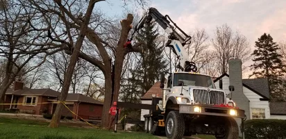

I have a 37 m ton effer with a jib like the rest of the treemeks and love it. Skip the little altec unit that don't have a jib, It's going to run short on large trees. Not to mention the gmt saw drifts down after u make a cut. U can't have that when working in critical area's around wires or close to roofsResized_20180504_203736_7520.webp

I have a 37 m ton effer with a jib like the rest of the treemeks and love it. Skip the little altec unit that don't have a jib, It's going to run short on large trees. Not to mention the gmt saw drifts down after u make a cut. U can't have that when working in critical area's around wires or close to roofsView attachment 54016
I would like to respond to the saw drifting down on the gierkink. This was my impression also until I talked to and. Watched an operator using one. He showed me how to operate it so the saw doesn’t drift down after the cut so that is not an issue once the piece is cut. There are other differences between the Mecanil and gierkink. Research the 2 and visit someone who has been using. Each so you can decide which fits your application better. It’s worth the extra time to research both the saw truck and crane to get what suits you best.
I stand corrected Mark, my buddy watched one in action as well the other week with you all and mentioned this to me the other day. I guess that feature must have been added since i last inquired about them..? Carl @Lumberjack you've used both the mecanil and gmt, can u help us out?
In this particular situation like when I'm over the primary wires i can actually apply the tilt function up before i even make the cut for extra clearance. Without being able to do what i just mentioned even if the gmt/mecanil don't drift, just from the momentum after the cut it will have the tendency to bounce down after the cut.. Zoom in on the pic to see how close the primary was on this particular cut.20180823_175259.webp
