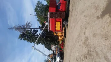

I'm just starting out, so don't laugh:
Originally
1. 1987 S1954 International w/ DT466 & 5/2 trans.
2. 125,000 original miles.
3. 18' Flat Dump that PO had 6' side bodies installed on. The body was way too long to use for anything other than cleaning out newly built houses.
It has been sitting under an oak tree for the last 10yrs, & has been bumped into by various pieces of equipment.
I have a replacement hood.
Tires have already been replaced.
All lines & hoses will be replaced before it is tagged.
As it sits now:
I will have 4' 6" in the clear for the platform.
I plan to haul a mini skid on the platform, as well as plywood storage & a Rigging box.
The chip bed is 11 1/'2' long 6' tall & just under 8' wide.
Paint is in order once the welding is complete, but I've not been able to work on it that much.
Total invested will be around $10k.
11.5'L x 7.75'w x 6'h = 19.8cy?
Is that enough capacity for a 12" chipper?
20160722_122707.webp Great start.. Even better since it will have a mini platform! I love mine, i built a storage for my tools into the mini platform as well.

I'm not laughing. That's a great truck. Pre-emision and simple. More importantly ... reliable.
Thanks guys. Can't wait to paint chipper this winter all black. Kubota weighs in around 12k. Been looking for a hook lift to match international. Not a bad set up for weekends.
Whoa, whoa, whoa .... whats wrong with Mobark red/orange?!!! Just kiddin' lol. Just get those "Mobark" decals in gold. ;)
