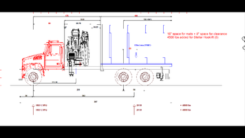

I’ve always loved your truck. What is the wheelbase c of front axle to c of rear axles?
How have you felt about maneuvering around neighborhoods and properties with that 260” + ?
The whole truck is just under 34', so for a crane I can't complain. The turning radius sucks. My old frieghtline kboom was a longer truck and turned better than my current western star truck. I can almost alway make it work, just takes some wiggling.
I do believe Ampliroll offers a setup to put up to a 35tm knuckleboom on a skid that the hooklift can load/unlod same as any other skid. I sure would like to know more about that, including what all is required to hold the body to the truck once it’s hoisted up.
Part of me wants to build a truck like @climbhightree but just keep telling myself not to go that big. Honestly, a wallboard truck with sides on the body would be sweet…I would never need to chip on site again, but a truck that long towing a trailer doesn’t really excite me.
