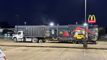

@Treetopflyer The tag axle is just an axle that affords greater ground clearance through its high lift suspension and smaller tires. The tag axle on the grapple truck is fantastic at hanging the truck up, making me use the differential locks and power diverter in the silliest of circumstances... I didn't build the grapple truck.
Payload is a fickle thing to define with legalities and practicalities that change with the circumstances. The truck weighs 18klb without a container. It doesn't struggle to handle 15 tons in the container. It had considerably more in that first picture.
A tag also allows towing heavy trailers, with or without a container and its reasonable payload. Here the container weighs ~19-20klb, 72klb combination.

The tag axel is great if you can add it after you buy the truck new. Having one on a new build will force you to pay excise tax on the truck. It's a lot of money. Just add it after.
