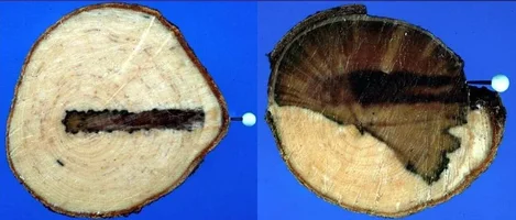

Yes indeed, sapstreak disease it is! Sorry I didn't catch Frax's entry. Me bad.
Most current workers don't accept C. coerulescens as the casual agent and go with C. virescens instead. That's not a criticism, it takes a human generation or two for general textbooks to catch up with current concepts. That's not a new name, or at least the virescens part is what the sapstreak fungus was first called. A later worker considered the bluestain and the sapstreak fungi to be the same species...some years back I wrote a little taxonomic treatment with the story.
Re: What Did This?
With respect to Guy's question, static images can be hard to interpret. The attached image is from a sapstreak inoculation study I did some years ago. The image on the left is of a disk from a sugar maple sapling that I drilled a 3/8th inch hole into about 2 years before. On the right is a disk collected at the same time from a sapling that I wounded the same way *but* added an active culture of the fungus right after wounding. The white pin marks where the drill bit entered the sapling. There was some variety in the patterns. This shows the cambial dieback pretty well in the diseased tree.
