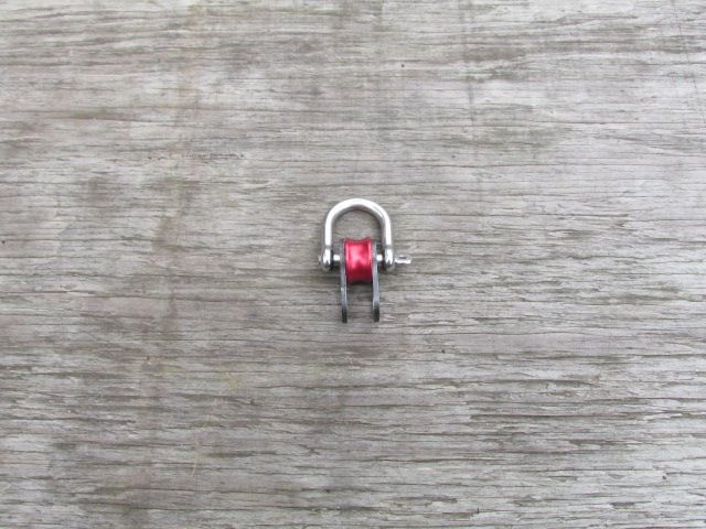

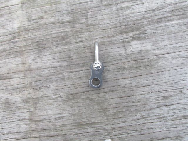

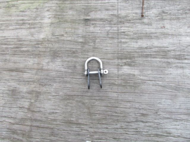

Does anyone use a shackle like this to tend the Hithhiker carabiner?
It seems this may make a good attach point for self tending the HH also on a doubled rope.
IMG_0486_zps8a4b6af8.jpg.html]
IMG_0487_zps26b92cab.jpg.html]
Surveyor, do you own stock in a large, privately held company that produces chain links!?!?!
Thanks of the continuing innovation. Have you tried this and found it effective? It looks like a great tending point in SRT as well...
Hey Eric, Some times it seems like I do! I have quite a collection and continue to work with various OAR configurations. I think the shackle would tend the biner well SRT with the HH and be strong enough for DRT also.
Levi, sadly I do not have access to a Hitchhiker to experiment with or post a picture with the above shackle. The spacing is right I believe, based on the dimensions of the HH, as the shackle is 1-1/8" wide between the eyes.
If anyone has a used HH system they would be willing to let me experiment with, I would send it back with the above tending attach point shackle as a way of thanks.

I'm thinking also that if I add the right size roller, fit within the HH, next to the biner (or shackle), that it would aid to ease the rope as slack is tended upwards,
