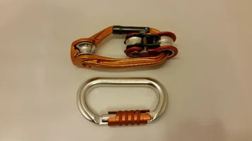

I have used a thimble prusic and revolver in the past, but find the Petzl roll n clip and the CT roll n lock to be faster to implement and smoother. They can be set and advanced after you get into a position that requires that 3:1 assistance.
Thanks DSMc. This looks like something I will try.
