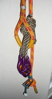

Hey, thought you guys might appreciate this one I threw together last week. Basically I had a pinto rig and wanted to play around with it until the pulleysaver comes out in the US, at which point I'll probably buy one.
The rigidity in the eye comes from a rubber shock absorber for the cobra mini spliced in. It had to be spliced into the core, using cobra lube to avoid messing up the braid, then the core put back into the cover (with great difficulty.)
One thing I'm not satisfied with is the retrieval end: at present I'm just using an oval screw link, but I want something plastic for this end. My thinking is that if I only have one metal object on the whole thing (the pulley) then I won't have to worry about letting it fly coming out of the tree, provided it's falling on to a lawn or forest floor.
I like the performance of the amsteel prussic cord; it slides well over the eye during retrieval, although I am somewhat worried that a rough barked tree could catch the braids. So far retrieval has been ok, though not as effortless as with my previous revolver/micropulley 2-ring style friction saver. One thing I learned quick is that you don't want to cinch the prussic too far up: if you're choking it, bring quite a bit of the rope through the eye, and if you're not choking it, just allow the prussic to sit on the eye. Cinching the prussic up so that it's snug on the stem will make removal a serious pain.
You don't need to worry about the two banging into each other and hurting one another. I'd be more concerned about the plastic snap breaking at the middle of a day when you have another tree to climb.

I bet you had a heck of a time getting the rubber into velocity. Yikes! Good for you for getting it done!

That looks slick Nick! I picked up one of those key pin D shackles from Wichard. Kind of pricey, but think it will work out fantastically. A 7/16" line runs through smooth, but its just such a perfect fit that I wont even need a retrieval ball, the whipping on an eye splice alone is big enough to catch the link, and theres no physical way a spliced eye will fit through it either. Should work out nicely!
Casey - Those splices look great! very nice set up. I've been trying to get one put together as well but still lacking in my splicing skills! What are you thinking you will use for the retrieval end?
Thanks! Below I have the finished product. I just went with a simple clip I got from a hardware store. It turned out really well.

Check out my final homemade pulleySAVER. Going to try it out sometime this week Again can't wait till the real ones are available.
