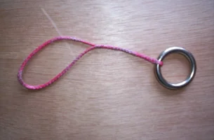

I just cut a piece of throwline and used two fisherman's to connect the ends, that spliced one looks sweeeet RogerM.
Here's two pics of the setup. Thanks again guys, the buzz is great.
jp
