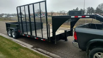

Dump trailer with platform for a mini....?

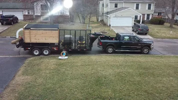

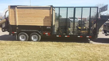

How practical is this set up TC? Does it go out everyday like this?
The mini usually rides in the dump trailer. If the trailer is full I’ll bring the mini home in the back of the chipper. It works. Not really ideal but much better than a lot of other alternatives. Works for me but I also have a bigger chipper and a smaller mini than most.

Midsota does offer axle upgrades or tri axle option to increase load capacity. Of course those would most likely require a class A license.
Tri axle option has give of 23k gvw
8k axle upgrade is 15k gvw
