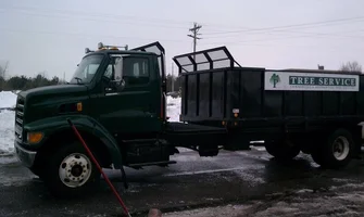

I will try and get a picture of a guys truck up here.
I think it was a L9000 with a platform for mini in front of dump bed. And he either pulled a chipper or his track loader depending on job. Was well thought out how he built it.
1998 ford and when I asked for pictures he said he has it for sale as he's building a new one. Message me for details
