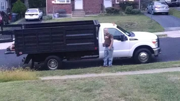

Did you see Islandedge's f550?
I wish I bought that.
Was on Treebay.

Saw this picture here recently.
You snooze you loose!

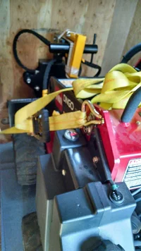

Make sure to use the tie off straps...

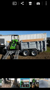

Thanks Guys. I was going to start trying low and slow yesterday actually. However a call about a fallen tree took priority yesterday afternoon so hopefully I can do some testing today. I am also looking at loading it through the side door Mert. I think the box will need to go instead of just moved but I will measure that all out when that time comes. By clearing the box and side door area I could also load logs from 2 places. Hit the dump body to shift everything to the rear and keep going. We all know loading into a truck from the back only gets you so far before you have more room left than you can get wood to.
Sorry about the extra random pictures. I was having trouble finding this one of Avant crossloaded in 14 foot dump trailer.
I keep looking hard at that setup myself. I am trying to figure out what makes the most sense for me since tree work is not my primary money maker. Actually since getting the Toro I've had 3 jobs that weren't tree related at all.

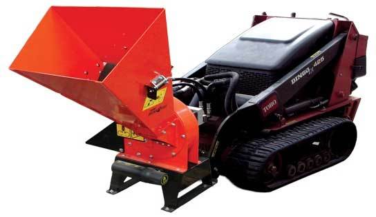

So am I the only guy who has ever considered putting a chipper on a trailer with the mini skid platform in front of it? Seems that most of the time I want the mini is when I also want the chipper. 1 truck and trailer rolling to the job site is my thought here.
With a big enough chipper you can put the mini in the back. And one of the best parts of all is no ramps needed!D3F248D4-8D3C-404A-8419-6EF587471054.webp
I was just going to get one of these, place it over the limb keep moving towards the tip lol. That should work right? And there is no need for a big chip truck anymore.
