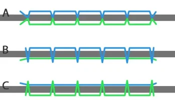

Why are eyes not stitched from this side?
Good question! Immediately, I can imagine it would put a properly placed lock stitch in "free air" between the two rope sections. That might allow more lateral movement between them.
The traditional splice puts the lock within the center of the rope.
Makes me wonder why not both? Perhaps because it's too easy for an industrial bar tack sewing machine to make 3 passes on a single plane.
I'd love to see what your splice breaks at!
I have an assumption...
The aim at (machine) sewing is to have a balanced tension between the upper and the lower thread (shown at A). This means the crossing of the threads should be exactly in the middle of the material (fabric, rope, whatever) and this gives the maximum stability to the stitching. Stitching from aside would result in crossing of threads between both ropes and therefore outside of any material.
Does it make sense?
