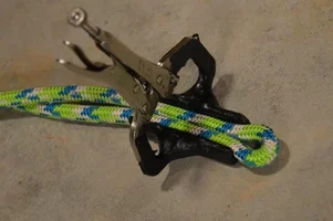

Check this photo out. I formed the eye around a carabiner to the size I wanted, with the carabiner still in place I taped the throat with the green tape. I took the carabiner out and flattened the eye down with the red tape to "capture" the eye size. Then I took the green tape off and pre-compressed the area to be sewn using 3 C clamps and the green tape.
What you see in the photo is after I took off the compressed tape wrap nearest the eye and started the first pass basting stitch.
