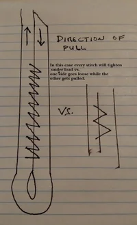

Here is something to consider.
Hand stitching vs. machine, try to take advantage of the fact that with the hand, you can do things that a machine cannot and turn what may be considered a negative into a positive.
By hand it is difficult to have the consistency and beauty that a machine can do, that may not be a bad thing as with the inconsistency more fibers are pulled into the stitch.
A machine can be very consistent in the tension of the stitch but cannot vary the zigzag.
By hand you are able to change the angle of every zigzag so that each stitch gets pulled when a load is applied. In other words, with a normal zigzag pattern, only one side is really holding the load but a sewing machine is able to apply enough pressure and put them close enough together that it is not an issue. By hand it may be.
Excuse my quick art, I am not an artist!
