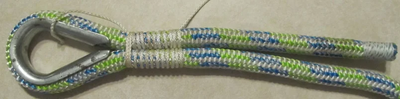

I wonder how racking seizing would work for making eyes.
It's usually done tightly, then covered with a second pass that doesn't go between the ropes.
I've seen pictures of where it was used on the rigging of old sailing vessels, so it must be pretty strong. And it could be done by hand little or no tooling.
Synthetic rope diameter contracts when loaded making the seizing ineffective no matter how tightly done, from what I’ve read.
That's true, but wrapping tightly compresses the rope before it is loaded. You can see the effect in the first picture taken right after wrapping.

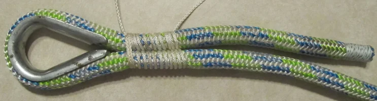

After loading it to 170 pounds five times, there's some shifting. A second pass that fits down between the first would probably reduce that a bit.
That's my first try using Voyager rope and #21 braided nylon twine (200 lb). If I was serious about using it for life support, I'd use at least three sections that size with second passes...and do a LOT more testing.
