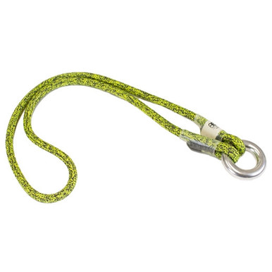

@moss Interesting product that I just found on treestuff, hand-sewn products. I'm not sure how long they have made this particular item or if there are any other hand sewn eyes on the site. But given the initial reaction to your sewing, I thought it was interesting.
It also says "spliced by the experts at rope logic." There's no desire for precision in that description.
It is funny though.
It is funny though.
