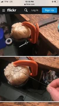

I've updated my hand-sewn eye technique, mostly about the preparation before sewing. No longer using small C-clamps. I've figured out that the primary purpose of the clamping is to form the eye size exactly the size/tightness I want, and to create as straight/non-twisting alignment of the two cordage sides of the join as possible. I'm using conventional woodworking squeeze clamps, speeds things up and gives me more control of fine pre-sewing adjustments in the cordage positions.
I've also refined the sewing technique to create more consistent stitching thoughout the 3-pass sewing runs. I've shot video to show that, will post when it's edited down, only needs to be a few minutes unlike my usual epic length vids ;-)
Photos and descriptions here:
Current sewn eye technique

Looks good! Is the purpose of the tape just to keep things together pre stitching? Or is there some other alignment/ measuring thing going on? Looking forward to the video, it can even be really long, I'll probably watch all of it anyways
Yes, the tape keeps everything in position while I sew. Cordage is squirrely and it doesn't like to stay put otherwise. The red tape on the eye captures that exact size and tightness that I want for the eye.
