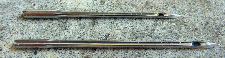

I do not have a complete answer to this question. but this information can get you some of the way. I noticed somewhere else, that the shank diameter of the needles to the Speedy Stitcher is near 2.0 mm. I suppose any needle shank diameter in the range 1.95 to 2.05 mm might fit the stitcher. On this website you will be able to find about 200 different kinds of needles with this shank diameter: https://my.groz-beckert.com/irj/portal/sewing#navurl://f184a2d3206d4115094d85559962dd95
This brand is sold Worldwide. But other needle brands can supply similar needles. You need to be aware of the "needle system" that fits.
From the 200 kinds you have to select a needle length, needle diameter and point style that you should like to use. I guess that a point style, "R" like the a standard universal point style will be right for the job. It might also be a more ballpoint jersey kind. I am not sure this is the whole storry, because the length of the needle shank itself might be critical for the speedy stitcher. I did not find dimensions of the shank length of these needles.
I have got one of the other kinds called "Sewing Awl":
I think it will be harder to find other kinds of replacement needles for this type, because the groove continues into the shank part of the needle. I have not been able to find alternative needles of this kind. See Photo:

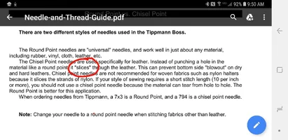

@Gymnast; I just thought I'd post a link here to a YouTube video that automatically followed onto yours as I was watching it. It is a pretty well done demonstration of how to use the standard Speedy Stitcher tool, along with a couple of leather crafting tools and tips along the way. He also chooses to use the Speedy Stitcher slightly differently than the instructions show in a couple of instances, because of hard-won experience. The guy shows the finished work at the end, which is nice looking work. Here's the link to that video.
Edit: I forgot to also post a link to the Tippmann Needle and Thread Guide in PDF format that @yoyoman was kind enough to mention earlier. There is some good info in this document that I did not know, about how to verify that your needle and thread are compatible, with regard to size.
Here's the link:
http://tippmannindustrial.com/content/Needle-and-Thread-Guide.pdf

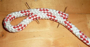

Just thought I would share my preliminary work. Going to very VERY crudely test it tomorrow (hopefully).
For my notes and everyone else following along. It's 9.3mm epicord (TEUFELBERGER says 7700 lbs) stitched with doubled up marlow #8 twine (79 lbs)
Traditional eye splice. Nothing fancy, just followed the normal directions, full fid bury with overlap in the eye. No lock stitching (ordinarily I would but it's rather stiff and I didn't feel like fighting with something that's going to be destroyed)
Eye with ring. Stitched with doubled up thread, using what a quick search calls a hemming stitch? Basically through the rope top to bottom, then across to the other piece of rope, then back through bottom to top, stagger with a zigzag pattern. 2 passes, once along the center of the 2 pieces of cordage, then once again through the "middle" of each cord. Overall length of the stitching is 1/2 fid length(4.75 inches). Call it ~84 penetrations. This should give (i hope) a strength of around 84*79*2 = ~13200lbs which is greater than the strength of the epicord. For the sake of completeness the ring is a ISC steel ring rated at 70kn, which is way over what everything else should break at. The ends are whipped and stitched additionally so the cord doesn't fray. The throat of the eye is also whipped and stitched to reduce the possibility of lateral loads pulling the eye apart based on a reccomendation found in this good old boat magazine video.
The end to end is a straight stitch, done in 2 passes down the middle of the cord over a full fid length (9.5 inches). Call it 68 penetrations which (I hope) should give 68*79*2 = ~10750 lbs. The ends of the epicord are also whipped to prevent unraveling.

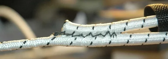

I got a comment regarding the eye stitching. Evans Starzinger did a similar eye test, that he commended here - see post #861. http://forums.sailinganarchy.com/index.php?/topic/154025-ropeknotsplice-load-testing/&page=9
I have copied the photo to here: Evans1.webp
It is a stitched eye loaded in pull test. As you can see, the stiches at the throat of the eye caries most of the stress due to the different elongation of the rope on each side. In order to compensate for this phenomena, I should like to bend the rope like this before doing the stitching: oeje klar2.webp

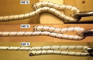

I did some photos of sewn eyes on shock cord for a project I had. This shock cord have a working elongation of about up to 120 % and this is much more than rope - but I think some of the same issues are relevant. Sometimes exaggeration can make you know more.
This is a sewn eye with no bending of seam with no load. This is with load:
This is a sewn eye with a bending seam at no load and at different loads:100-140-220pct.webp
