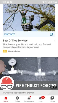

LoL... yeah, I went to one of those sites that finds various service providers and contractors for you, in your area. There were just tons of these pictures of them doing stuff that would give OSHA a reason to cringe. It was almost comical, if it wasn't so sad.

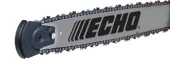

The Echo tophandle saws come with an attachment on the end of the bar that is an anti-kickback device... it covers the tip of the bar/chain so the chain can't contact other branches, etc. that you might not see. Everyone I know removes it immediately. It interferes with much of the cutting we do. However... since cutting palm fronds allows you to slice across it easily, it would probably prevent the overwhelming majority of any kick back threat, in what you're doing.
Just a thought. I believe that Echo may have stopped equipping them on the saws from the factory, but it is still available as an accessory. Could certainly make one-handing in your situation a lot safer.
