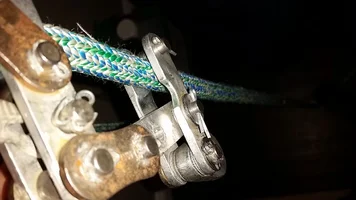

I'm trying a vortex mod that I think has great potential.
I have replaced the bottom friction link with a single pin to hold the bottom arms to the spine (allows for adjustment in the width of the gap between the two arms and even the spine thickness).
It also let's you increase the space between the friction pin (slick pin) and the spine.
In effect it gives you unrestricted adjustment for rope diameter.
I haven't tried it weighted yet and the gap in this mock-up needs to be adjusTed. 20150208_225352.webp

Would love to see how that works! That bone is ancient

Looks like a great idea, TreeGongFu!
