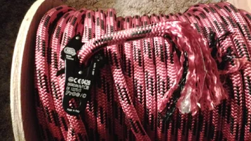

Thanks Eric. I was at the Harrisburg Sportsmans Show so sorry for the delayed response. While there I pickedup a Kong Frog and 225 feet of Yale XTC 24 11.7 Sunburst i think for dirt cheap (50 cents a foot). It's reddish and black as opposed to the Sunburst color but the identification ribbon reads as if it is the Sunburst. At some point I iintroduce it to the bones and report back on how they play together.

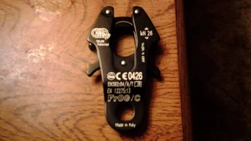

I'm thinking maybe as a lanyard end to try out. They are 26kn and I think tower guys have been using them for a while. I tried clipping it on the D rings on my saddle and it works pretty good. I know I have seen them around some but I need to do some Google research and make sure. Well and then see if I trust it.
I know a years ago guys on here bought some of the original versions but could nrver really find a practical use for them in the trees. I may not either but for $20 how do you not buy such a cool looking device.

Looks like you scored pretty good there ML. I sure hope you enjoy all that. It'll be one of your first departures from Vortex?
It will be, I figured I'd give it a try. If I don't like it I can always hang my ZZ from it, yes I still love my ZZ and sometimes Ddrt just makes more sense fgor the task at hand.
