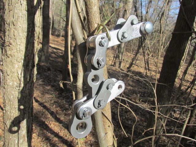

Steve, yes the D-ring at the "Sweet Spot" is intended for tending the Bone during ascent, do not transfer weight there when sitting back. My thought is a longish tether or bungee for tending.
It is easy to add a 7/8" D-ring just beside the top joint link as pictured.
Here's it is.
Welcome to the club Steve!
The bollard sheave isn't visible in your pic, but I'm quite sure Gordon sends them out with the 5/8" installed, which will match your 11.7mm line.
Just look at the upper link (where the rope installs on the top arms). The pivot pin of the link will have a sheave installed between the two upper arms. Yours is most likely already the 5/8". You can change the bollard out by pulling the cotter pin and sliding the link out.
Hope that makes sense.
