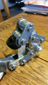

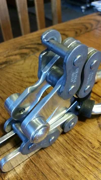

I did some work on my BDB today. The first picture shows the finished shortened upper arms which are now identical to the bottom arms except for the end buttons. It now has a notch like on the bottom arms and some removal of the aluminum on the inside for the rope channel. The second picture shows an advancing tether made from a short nylon strap that is held on by rings. I also made a new spine out of 7075 T6. Not only is this far stronger but with no tending hole it can be rotated so that it has 4 different contact patches, should last a long time.

I have not used the tether yet so that could possibility need some tweaking but everything else works great.
View attachment 29205 View attachment 29206

Looks beautiful David! The strap is so very tidy also, and if need be you could move it to the upper portion of the double joint, just be careful not to transfer weight onto the strap while leaning back. My new batch of Bones also has a half moon notch in the upper arm, and the spine joints are beefier, as is the teardrop where it fastens to the lower arm. along with SS links at the double joint and teardrop attach point.

I shortened the top arms but found that it altered the way they sat on the bottom arms, in the collapsed position, in such a way as to create more friction when tending.

I find that interesting. It would be nice to see what is going on with yours that is different than mine. The original thought for my shortening of the top arms was to improve slack tending by bringing the top link closer to the spine so the rope path would be more direct when it is in the collapsed position. This works very well on mine with a bonus of much better control and an easier initial release.

The difference may be that mine lacked the nubs on the top arm allowing the top arms to fall between the lower arm friction links.
In your pictures you can see that the nubs don't allow for this
It wasn't a constant drag on tending but it would happen or occur quite regularly on ascent.
I have replaced the arms and made nubs for them and it is nearly frictionless tending.

Gordon, I have tried the upper part of the link for the tether point and, as you say, it works well for the tending part. I do not feel it is a good or safe practice however, because the BDB just will not grab if there is any tension at all on that link. Having it on the lower pivot point works almost as well and is nowhere near as dangerous.
