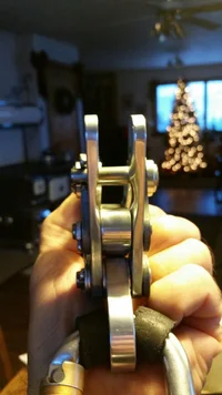

2014-12-25 08.36.38_resized.webp 2014-12-25 08.35.29_resized.webp An update on my altered for fat rope, BDB. I did have to move the tending strap to the top link position to get satisfactory, smooth tending. I did test it and it grabs reliably, even with some force being applied. I tried to get a picture of how straight the rope path is now. As you can see the top link sits very close to the spine when in the tending position. This means that the rope passes through the links while they are at their widest. So far I am very happy with how this is working on Vortex.

View attachment 29270 View attachment 29271 An update on my altered for fat rope, BDB. I did have to move the tending strap to the top link position to get satisfactory, smooth tending. I did test it and it grabs reliably, even with some force being applied. I tried to get a picture of how straight the rope path is now. As you can see the top link sits very close to the spine when in the tending position. This means that the rope passes through the links while they are at their widest. So far I am very happy with how this is working on Vortex.
Looks very polished inside. Any tips on putting a fine polish on this thing? I'm considering having mine anodized.
My BDB has all new aluminum parts except for the teardrop and chain links but the original parts can be made to shine like mirrors with just a little time on a 10" buffing wheel. For best results you will need to take it all apart and hit each piece individually.
David, can you post the all the mods in your most recent update? Mostly, it seems you've shortened the uppers, but is that the hinge point length?
