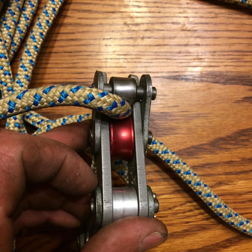

Attempted running the bone on 10 mm beeline blue with the dmm spacer. It slipped so I added the 5/8 bollard on the chain link along with the dmm spacer and it worked.
You say it worked, but could you elaborate? I imagine you just wanted to see if you could get it to hold and didn't run around a tree with it, but from the looks of it in the second picture, the arms are getting really upright. How did it feel to break open/release/control on descent?
Also watch out that the sleeve doesn't slip to the side over the link plate - the rope could then slip the other side and jam or cut get cut against the other plate.
