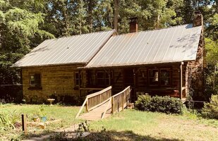

The logs are all southern yellow pine, with cedar on the interior gable end, and shiplapped pine that we milled on the cathedral style ceiling. the full basement uses oak beams that we rough sawn (at a local mill) down the center to support the floor stringers. The foundation walls are stone veneered as is the chimney with stone we salvaged off a road construction project. There is 2 inches of styrofoam insulation on the roof and 1 inch in all the chink joints. The concrete/masonry chinks are held in place by expend metal lathe (inside and out). The ash tree which Caleb removed for us (it was leaning more and more over the house) was born about the same time I was. You can see the stump in the picture.
