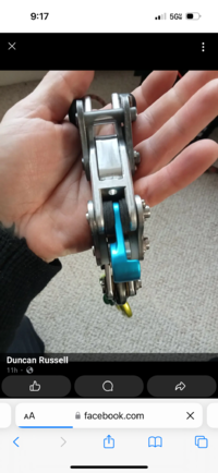

The fellow on Facebook has a DMM swivel on his Bulldog Bone. I use the RE nano swivel as an option on the Bones I produce. ( the gold color in the picture is actually the biner)

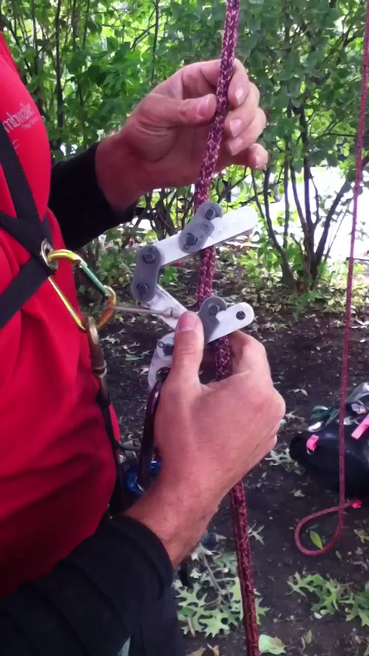

Blast from the past. This is the first purchaser (Mac Swan) of the Bulldog Bone. It came with 3 different interchangeable size bollards and no rubber nubs. It also had a sheave with a quick release axle that you could install after installing the rope onto the bottom arm, which was deemed unnecessary by many.
