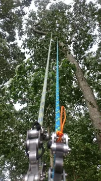

I made my bdb a few years ago, 7000 series alu. I integrated the tending point to the top link by making the spacer oblong with two holes. I run a swivel on my shoulder strap, rope tending starts at about 6 foot off of the ground. Instead of using taper pins on the open links I put a little dab of weld of the holes to keep the side plates from ever slipping off the end of the shaft. Also the top and bottom arms have notches that the friction links rest in, even if the side plates of the links are open all the force will not be applied to the riveted pin. see the first picture
I made my bdb a few years ago, 7000 series alu. I integrated the tending point to the top link by making the spacer oblong with two holes. I run a swivel on my shoulder strap, rope tending starts at about 6 foot of the ground. Instead of using taper pins on the open links I put a little dab of weld of the holes to keep the side plates from ever slipping off the end of the shaft. Also the top and bottom arms have notches that the friction links rest in, even if the side plates of the links are open all the force will not be applied to the riveted pin. see the first picture
View attachment 44792 View attachment 44793 View attachment 44794
