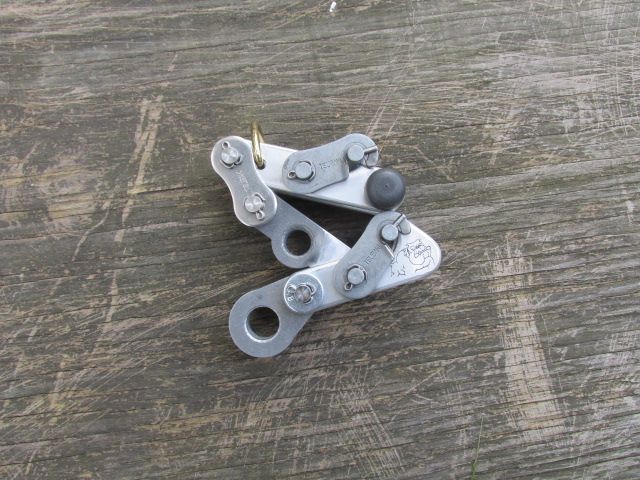

Mcmaster-Carr makes 1/2" long steel taper pins that can be inserted into the 0.10" dia. hole in the end of each friction pin on the Bone (which can be press fit). This provides additional support to the outboard end of the snap swivel link and does not interfere with the insertion of the rope into the arms.
Any chance to get a picture up on that?
Here is a picture, notice the taper pin at the end of each snap swivel link.
You'de the man that would know what would be politically correct Gordon, but was there a situation that brought this about? I see the rope possibly getting picked while midline attaching with the cotter pins attached. Was there an incident that brought this about? Or is this a CYA, manuever?
There has been no incident, it just seems like a simple way to make the Bone even safer. The taper pin does not protrude through the friction pin, so it does not impede the installation of the rope into the Bone.
