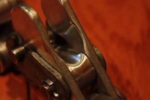

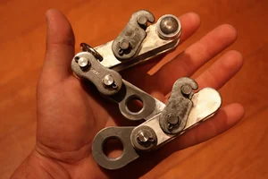

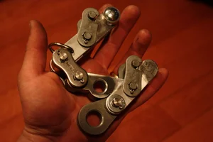

Gordon, I had some time to take a few updated photos to show the current state of mine after using it on every climb since I got it. I really can't see much wear and it is made climbing SRT a dream. I seriously climb with it all the time.
BEFORE:
AFTER:
BEFORE:
