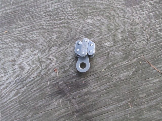

I continue working on the lanyard adjuster. Here is a teaser.
