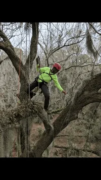

CLIMBING HAZARDOUS OAK TREE
I love the salami cut for small tops like that in tight dropzones. View attachment 59616
Salami, pepperoni, mortadella? Down here on planet earth we call that a slice cut? A highly effective cut, but one needs to be careful when using a slice/spear cut to top a tree. During a well executed slice cut the butt will slide off the stump very quickly, and the top will remain near vertical or even sit back a little as it bombs towards the ground. This means that any brush on the backside of the top has the potential to slap the crap out of an unsuspecting climber! The more vertical the top you are taking, the more the potential to get your bell rung. Been there done that!!
Watched the video again and every single cut in the vid is pretty jacked up Kenny. The entire video looks as if it is running at double speed. Deliberately slow down, and get in the habit of striving for perfection on each and every cut.
#1- Top cut. Never sighted cut. Angled portion of your under-cut was not even close. Never even inspected your under-cut. Undershot back-cut. That pesky follow through we talked about earlier which cause you to cut off your near side hinge.
#2- Limb cut. Again a very hurried under-cut that was never inspected or cleaned up. Another undershot back-cut. You did just the opposite of what was necessary to get this limb to swing to the right as intended. You cut off your uphill hinge, while leaving a big plug of hinge on the down hill side. 180 degrees bass ackwards of what you wanted to do.
#3- First chunk. Never sighted or cleaned up your under-cut, and I can guarantee you had bypass on this one. The chunk sat down on the kerf from your bypass and came to a screeching halt, forcing you to plow through all your hinge.
#4- Falling cut. You can see from the close up of the under-cut that you have some serious bypass on the angled portion of your cut. Freeze frame at 3:21 and it tells the story. Bypass, overshot back-cut that is no were near parallel to your under-cut, and absolutely no remaining hinge.

Kenny it's great that your hanging around for some great insight. I would recommend you take a 30ish x 16ish inch piece of wood and take some 16ish inch lengths of branch wood and lag screw them to that stump piece. Then practice your notches man! Practice until you can make those cuts perfect in your sleep bud. When you get good at it with the "branches" vertical then start attaching them at angles and practice some more like that. When you get good with angles start practicing with different species. Then practice some more!
I remember the first time I saw one of your videos my initial impression was that you needed to slow down. That is the exact same impression I got when watching this vids. Slow down and lock in on making perfect under-cuts and back-cuts every fucking time, and for the love of Gawd please stop destroying your hinge Kenny! Pretty please?

I really hope you stay @Kenny Sanchez and take these tidbits of suggestions. You will grow and become better. This will allow you to help others. That is how the industry grows.
I agree 100%. And thank you to everyone who has tuned in and given their input. I have a question tho. If you guys are suggesting that my best choice was spear cut, what does it matter if I purposely cut through my hinge in my humboldt cut? I definitely get i rushed on everything, that fucker was sketchy and i wanted to get off it as soon as possible.
Because when you bypass your undercut or cut through your hinge you make that cut null and void. It basically has a mind of it's own. In this scenario you seemed to have room for error so it worked. Most times on creates a hinge to steer pieces in a certain direction. It is over used by many who do not understand it's basic function and properties. Rushing in a compromised tree is a road for disaster. Stay calm and be precise. If you cannot do so leave it out for someone who has that skill set.
Sketchy trees are sketchier with rushing.
