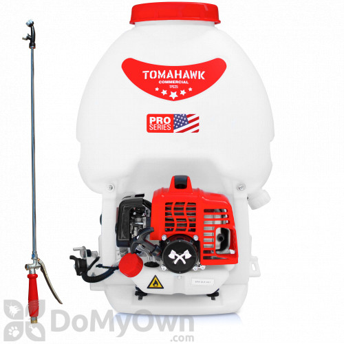

I’ve never used it, but I’ve been eyeballing this in the Midwest arborist supplies catalog for a while.
I don't see the cart option in the below link but it is in the attached picture. Would probably fabricate my own cart with some bigger tires. I'm not a fan of carrying sprayers on my back, can never tell if its leaking or if I'm just sweating :oops:
Any thoughts on this thing for oil sprays on crabapples and fruit trees?

I bought the 2 stroke one earlier this year for soil injections. I'm not ready to get a whole spray rig, but I needed a lot of pressure for soil injections, so this seemed to be a good option; I don't think that tomahawk one has the ability to attach to a soil probe, IIRC. I haven't had any problems with it and I don't doubt it puts out 350 PSI on full blast. I haven't used it for any above ground spraying, but it is well built and relatively comfortable for being a giant motorized backpack sprayer.
The downside is carrying a 20 pound sprayer with 6.6 gallons of water, and then stepping up on the soil probe to push it into the ground hundreds of times in a day. I've got some really nice quads now... refilling the tank so often is kind of a pain though, too. The tool itself is great. But when it comes down to actually using it, it's pretty miserable. I wish I had just gone for a skid sprayer for what I'm doing, or had an employee who doesn't mind working out his legs.
