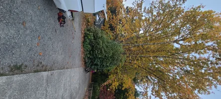

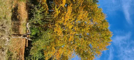

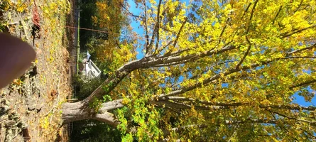

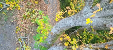

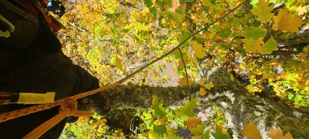

Yesterday, went back after recommending reduction 6 months ago, to see a neutral-plane fracture 6+' long. I wish I could have done some significant, lighter reduction to prevent the crack than hard reduction to prevent large failure.
This is a friend's daughter's home and preschool site.
I scratched my various plans for the day and started some significant reduction at noon. At 330, my groundworker came for 3 hours.

I reduced long, long horizontals, then started on the biggest trunk coming from an old topping-cut 'hydra's head" that contributes lots of load, particularly toward the house/ school parking area. and many long, long-dead branches. There are also several long-dead upright trunks that many would call trees within themselves (12"x60'+).
If only photos could be posted to the internet in the regular direction.
