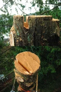

Here's a notch I used today.
THAT'S the way you do it. No slipping outta THAT!
Thanks for posting a pic of the PROPER WAY.
